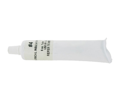

At every oil change, I take the gas cap off, and thoroughly clean the rubber seal, then lubricate it with DC-4 (Dow Corning #4 Silicone Lubricant)
In the 8 years that I've been driving KIA's, I've never had a problem with my gas cap not sealing properly.
