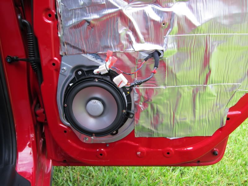

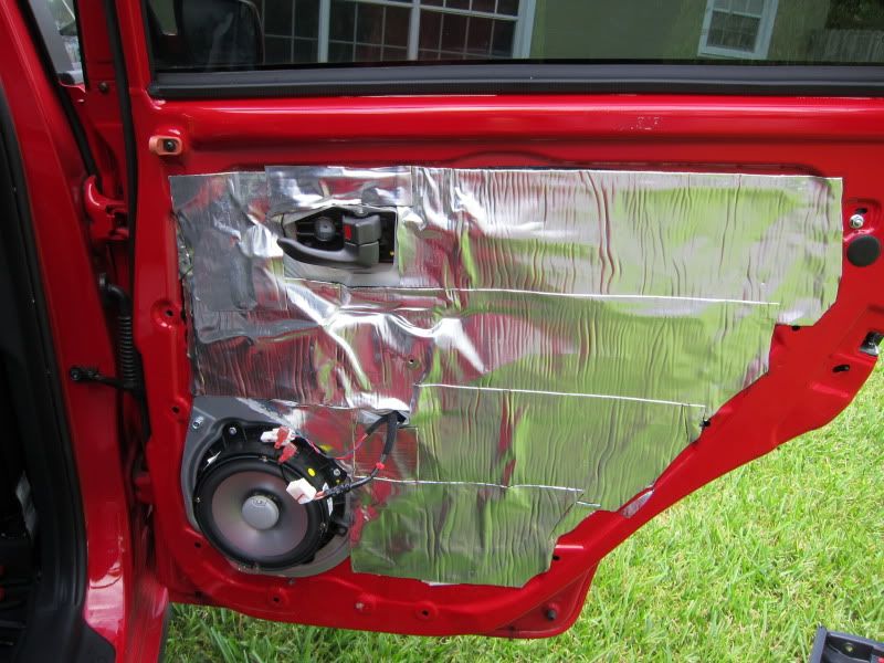

Check out the pics....I put quick disconnects to the speakers and the other ones you see are for the rear LED speaker lights. Yes I had to put them in the back also!!
The fronts are next, anyone keep the front lights somehow with aftermarket speakers? I'm going to try!!

BTW, did you put any peel and seal on the interior door panel itself, I've been thinking of doing this. I've noticed my midbass is better since I did the inner door skin, but I find the interior door panel vibrating a bit when the volume goes up.
I'm probably going to do it either way, in just a few spots, but I have so much deadener with the inner door and outer door both having about two layers, the doors are getting a bit heavy..lol
I also ran new 14g wires to the doors for some new speakers I'll be putting in this week, and I found out that the little rubber wire shield/grommet (can't think of the right name for that thing) between the door and the jamb is actually a plug on the one end, so I had to run the wires through the actaual grommets of the shield. Just an FYI if you plan to run new wires for your speakers.

Don't think I'm going to run new wires as of yet. I found out about the door wire plug when I did the back speaker lights. Check out my other thread, I just put the fronts in and kept the speaker lights. I know some people don't like them, but just wanted to keep them for my little one.
