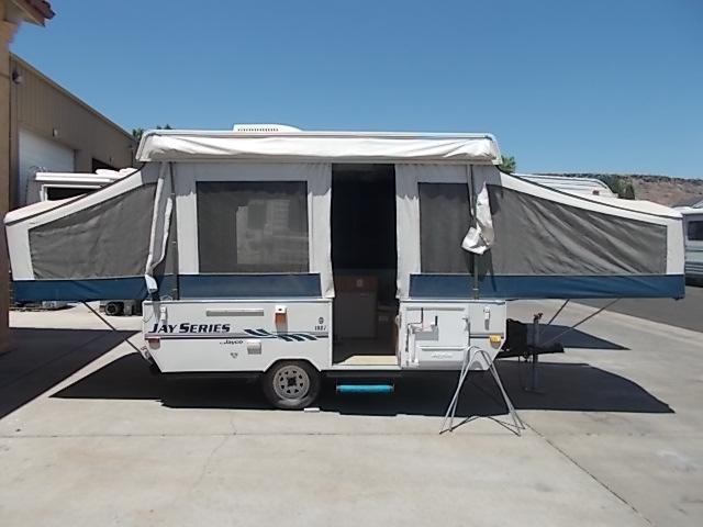

The guys and gals who know all about towing will be along shortly to answer your questions. What I'm wondering is this a pop-up tent you are talking about? Or do trailers themselves pop-up?
767 Posts
Probably something similar to this:
My Father-Out-Law has one of these, and has been using them for years. Loves 'em!
