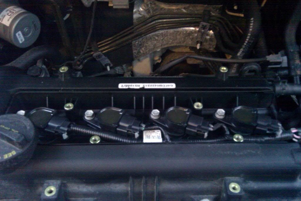

First obviously raise the hood to get a view of the coil cover and notice the four bolts around the perimeter. These bolts are 10mm.
We need to remove these four and place them out of the way (i use the cowl perfect little bolt holder), and then the cover simply lift right up. underneath this lies the four coils, one per plug.
These as well are held down by 10mm bolts similar to the ones used on the cover, but do take note that these bolts use a lockwasher whereas the cover bolts do not. Again remove the bolts and put them aside.
You may notice that there are connectors on each coil and be tempted to remove them, this is not necessary.
Next after all four bolts have been removed starting from the passenger side pull each coil off of it's respective plug.
