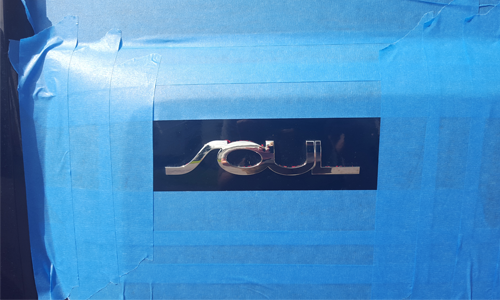

Step 2: Taping
Now you will need to tape off your work space. Leave about 1-2" around the edges of your emblem to ensure that you have wiggle room to work with later. Trust me, there's no need to work right-up on the edges of the emblem itself, that's the beauty of Plasti Dip. I suggest painters tape as it won't damage your vehicle's paint when removing it. Plus, painters tape is fairly cheap and can be found in most stores. Use the masking paper/newspaper to ensure that overspray can be caught to avoid unnecessary cleaning further down the road. I suggest being liberal with your papers as even the slightest wind will make sure that stray Plasti Dip finds its way onto your vehicle.

You will be left with a rectangle of dip (more or less) around your emblem. From here you can begin the careful process of removing the dip. Using your fingers pull away from the emblem, taking the dip away from the edges as it tears. To get smoother, clean edges you can use a straight razor or a toothpick to outline around your emblem beforehand. That way when you begin pulling away the excess dip, you won't have to worry about tearing off a part covering your emblem in the process. Once you completely remove the extra dip from around your emblem, if you have any small frays/hanging pieces, you can use the straight razor/toothpick to push the excess back down behind the emblem if it can't be completely removed.
Now you're left with the inside of your lettering. Use a toothpick to lightly pick/scratch at the dip until it begins to pull up and away from the emblem and the vehicle. Again, use the straight razor to make clean edges in advance. Using the toothpick, work your way away from the emblem and eventually you will be able to grab on with your fingers and pull the extra dip off of the vehicle. It took me about a good 10 minutes to be able to work the dip off of the center of the "O" in the Soul lettering, alone.
