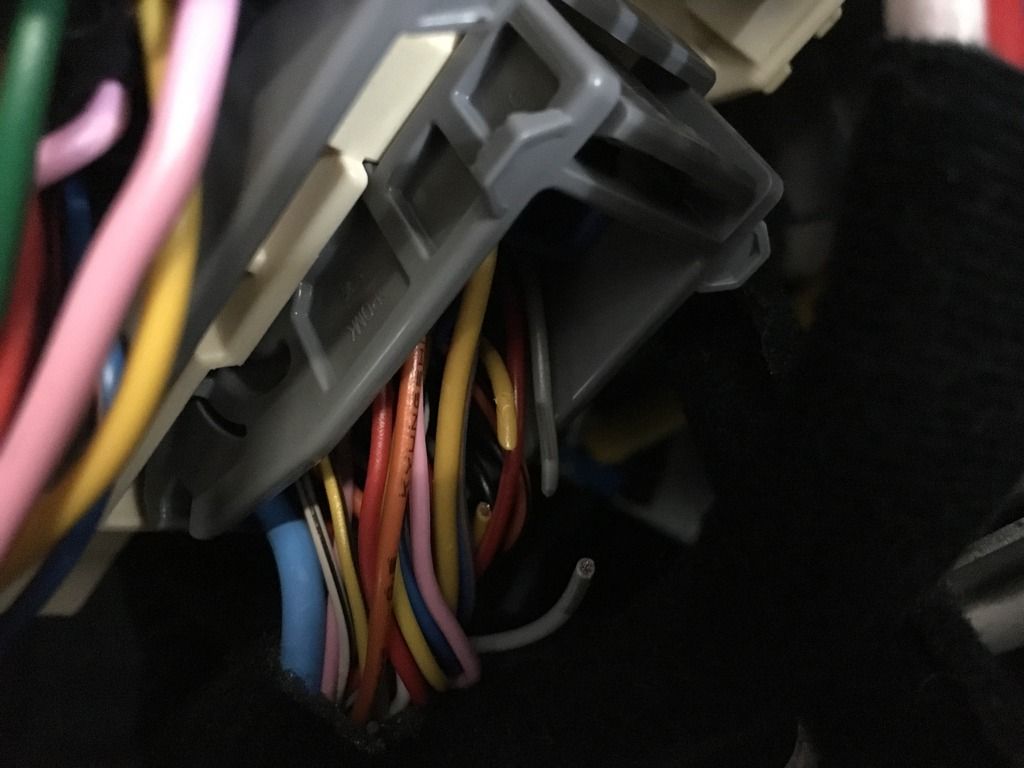

So I did a bit of measuring and testing today and found the wires that supply the low voltage to the DRL.
The connector is located on the right side of the fuse panel under the dash. Use a good volt meter to find the wires (mine were gray and yellow one for each side)
with the car running and the DRL on, find the wire with a 5.0VDC supply, with the lead still on, pull the parking brake lever, the voltage should drop to 0VDC. I triple checked the wire before cutting.
Put some tape around the cut cables and it's good to go, no other functions of the car are impacted. This can be also reversed by re-soldering the wires.
Now DISCLAIMER:
Disconnect your battery before actually cutting!
Please do not attempt if you're not familiar with basic electronics, serious damage can be done if the wrong cable is cut!
I'm in no way responsible for anyone else doing this, attempt at your own risk!
Lastly, I am aware of the reasons we have DRL and it's benefits. I will be quality installing DOT approved LED DRLs on the car (Philips) [URL=http://s1224.photobucket.com/user/Gabriel_Sebestyen/media/IMG_0440_1.jpg.html][/URL]
