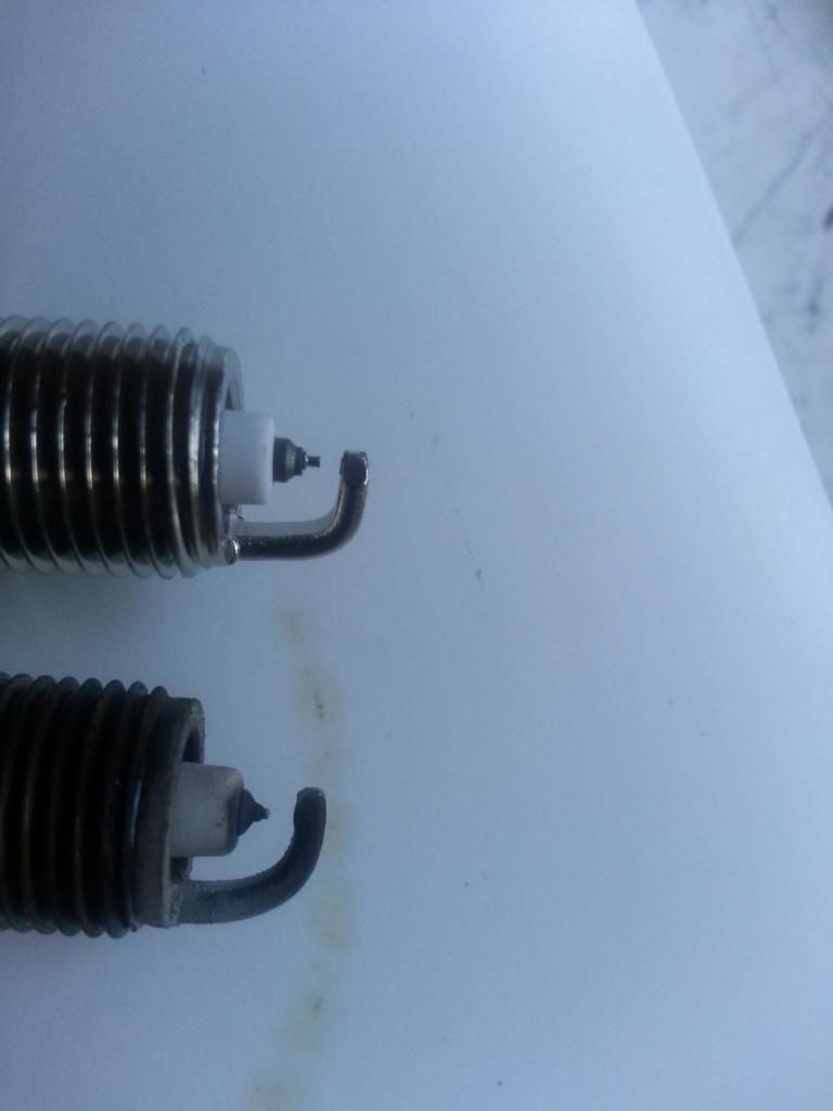

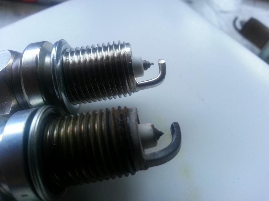

Decided to buy some Spark Plugs & change those out while I was at the parts store.
Original NKG looking Worn down, 115,000 miles

Those plugs didn't look all that bad, but probably should have been replaced a bit sooner.
Replace with a like type plug. OEM plugs are actually pretty darn good!
