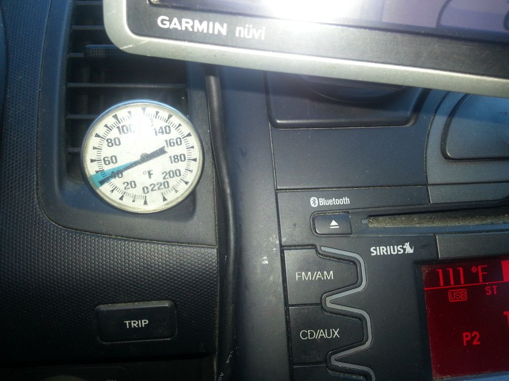

A/C still blows cold cold cold, it was hot hot hot the other day so I took this picture

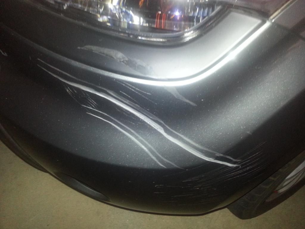

2013 - Front clip ripped off by passing car ( $ 3600.00 )
2015 - Front bumper scratches ( $ 800.00 )

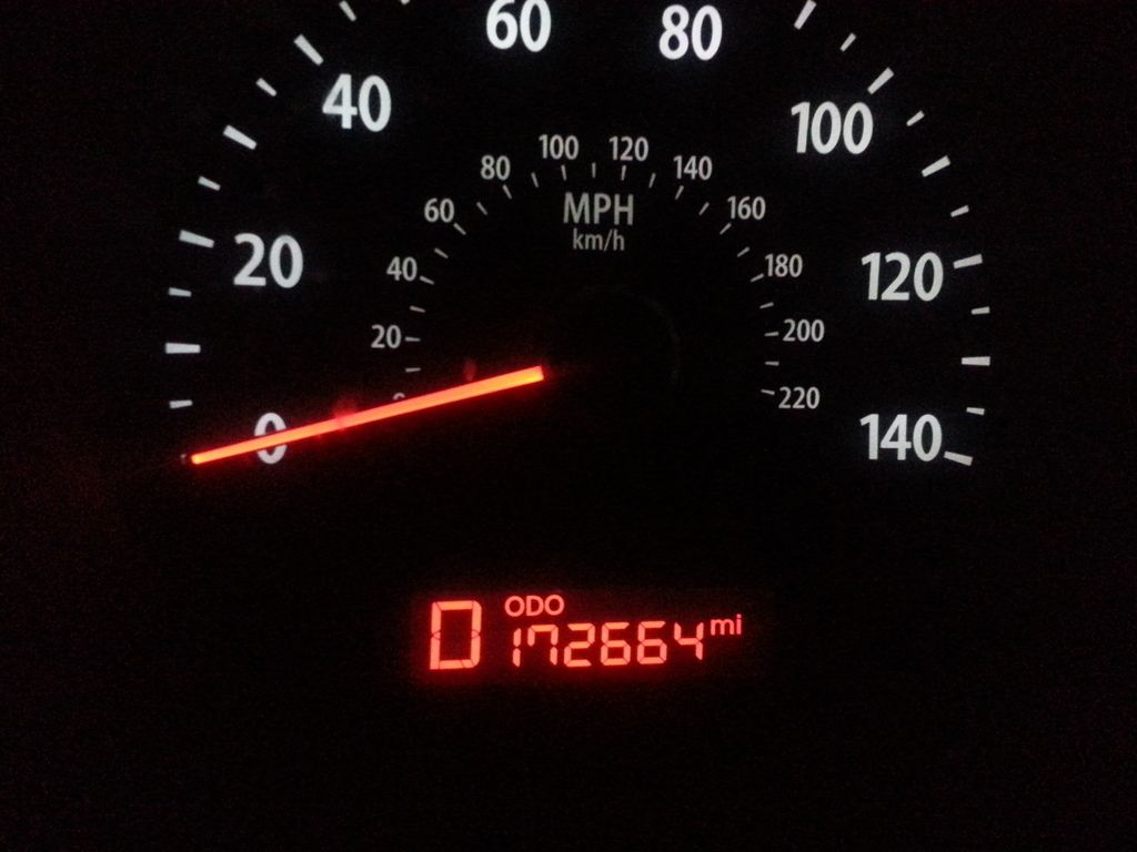

List of Repair’s - Service done in last 7 yrs:
100 miles = Loose Sensor on motor causing rough idle ( w/a 0.00 )
5500 miles = Blown turn signal fuse ( w/a 0.00 )
12,000 miles = one of the front parking light bulbs burnt out, I replaced both
15,000 miles = one headlight, upgraded both with PIAA
25,000 miles = Replaced failed PIAA's with a H.I.D. system
30,000 miles = passenger side mirror motor - motor works but won't move mirror
44,000 miles = Battery - Just under warr by 1 month - ( w/a 0.00 )
52,000 miles = New Tires ( 500.00 ) Yokohamas
58,000 miles = New windshield wipers ( 10.00 )
61,000 miles = Brake light Switch ( under W/A , But I replaced myself @ 22.00 )
71,000 miles = New Windshield (Free) + $ 100.00
80,000 miles = Replaced front brakes, repaint calipers ( 75.00 )
103,000 miles = Timing belt, a/c idler, power steering flush, new water pump ( 1000.00 )
109,000 miles = New Tires, Yokohama’s again ( 550.00 )
111,000 miles = New windshield (Free) + $ 100.00
115,000 miles = New Battery & Spark Plugs
125,000 miles = Both front sway bar links ( 60.00 parts my labor)
140,000 miles = Front passenger wheel bearing replaced ( $300.00)
145,000 miles = E C G plunger sensor ( 120.00 )
155,000 miles = Alternator replaced ( 295.00 my labor)
156,000 miles = Fuel pump replaced ( $ 725.00 )
157,000 miles = New Yokohamas Tires ( 575.00 )
160,000 miles = Front drivers side wheel bearing replaced
161,000 miles = Battery replaced ( $ 110.00 )
165,000 miles = New Windshield (Free) + $ 90.00

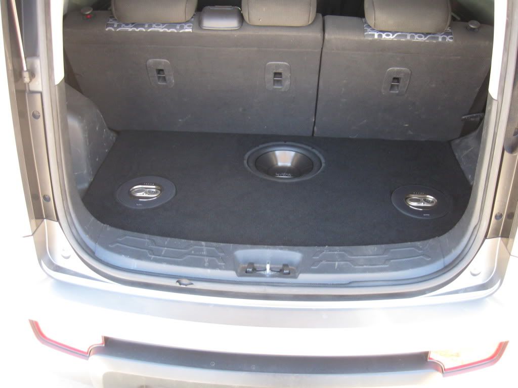

Stereo upgrade included a custom speaker box
