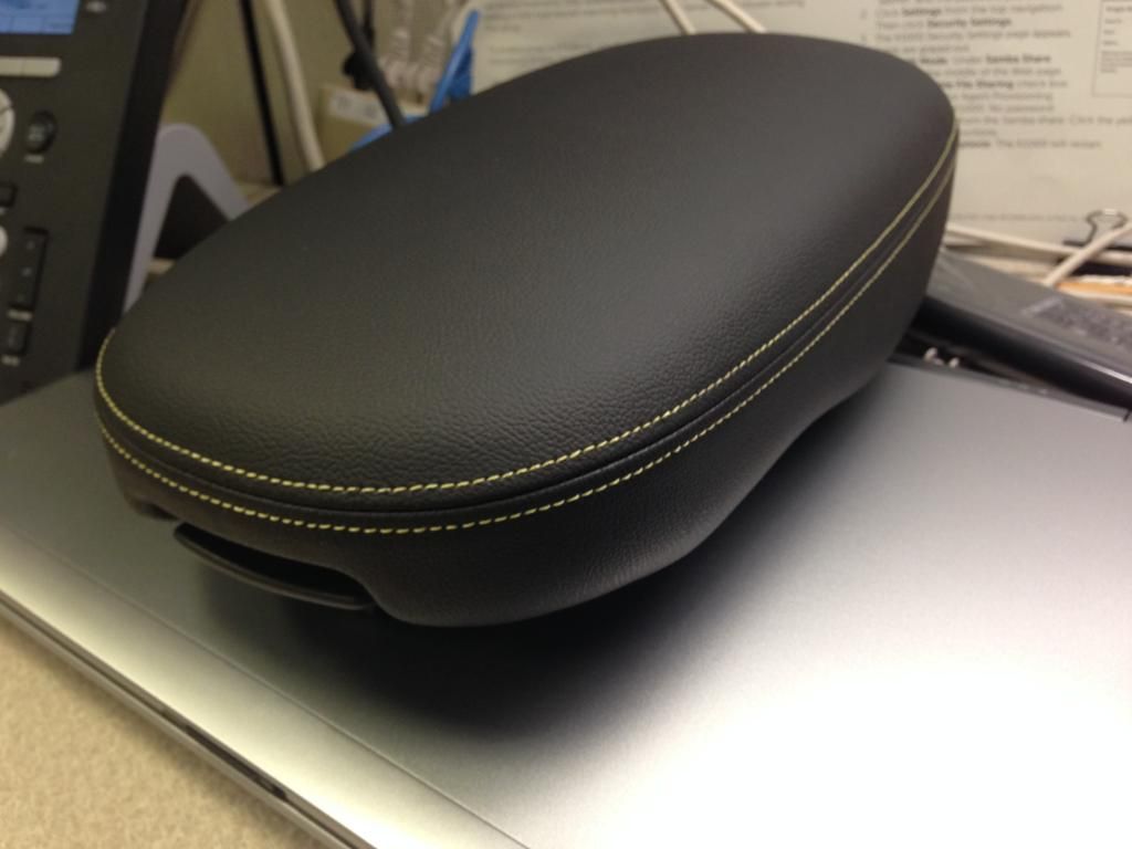

2014 Titanium Stick Shift Pacific NW

68 Posts
I just reordered my two pieces so wish me luck! My actual center console arrived from Korea today! That was pretty quick all things considered.
68 Posts
Any chance that 84660B2000EGY could be grey stitching?
I had to order the following from Four Green:
84660B2000EGY ARMREST ASSY-CONSOLE - $94.29
84611B2100EQ CONSOLE-FLOOR - $55.00
and that's before shipping.
I will be sure to post pictures of my install. I'm hoping EGY is grey or something. LOL
So.....EGY is NOT Grey Stitching, more like yellow stitching.
