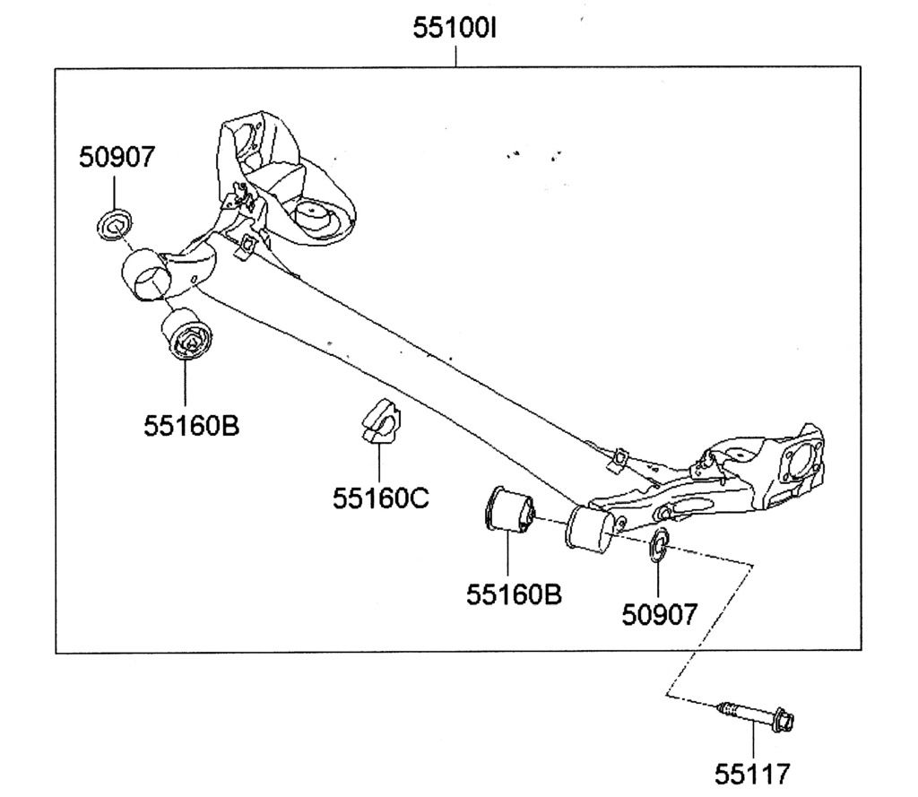

Problem solved, control arm bushing part number 55160b bolt was not tightened at the factory. I tightened it this morning and the car as quite as new. KIA PART.jpg I tried to attach a picture of the schematic but no joy. Thanks to everyone for helping me brainstorm this problem.

Problem solved, control arm bushing part number 55160b bolt was not tightened at the factory. I tightened it this morning and the car as quite as new. View attachment 116569 I tried to attach a picture of the schematic but no joy. Thanks to everyone for helping me brainstorm this problem.

I had this squeak form the rear “axle” bushing during the winter cold days. I got pissed and didn’t bother looking. I started to think of how much on a PITA would it be to replace them bushings. Car has 117k. I already replaced front control arms. But this is fairly easy. I was scared of this being rusted shut like they usually are on the other car that I chopped up after scavenging parts of it (not Kia).
So I rather being loose then rusted that I can’t take it out.
